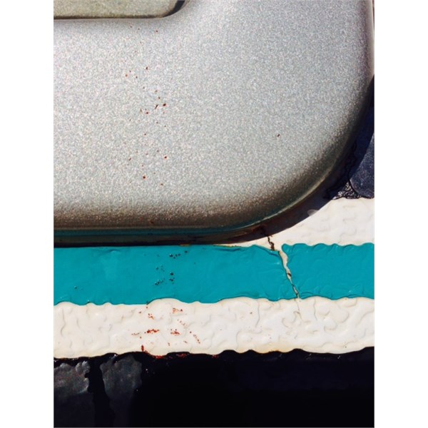

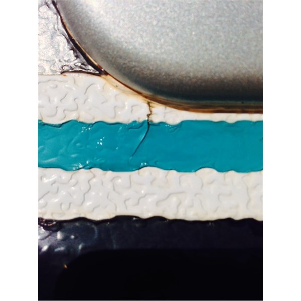

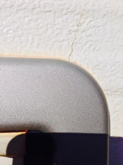

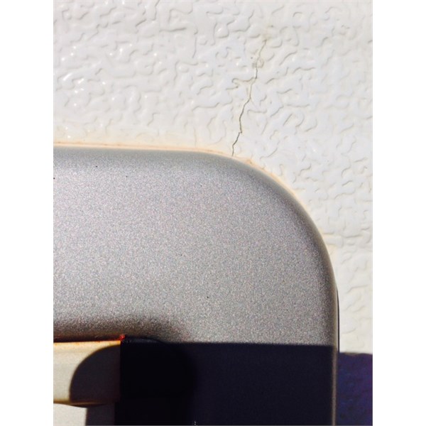

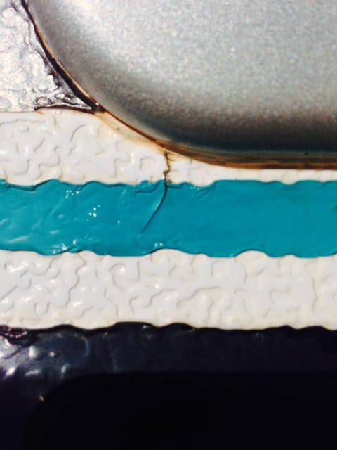

Reply By: cobar - Sunday, Aug 23, 2015 at 10:39

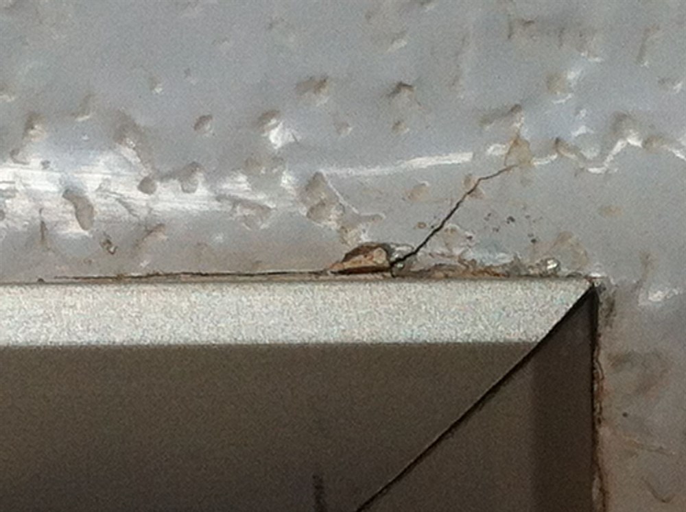

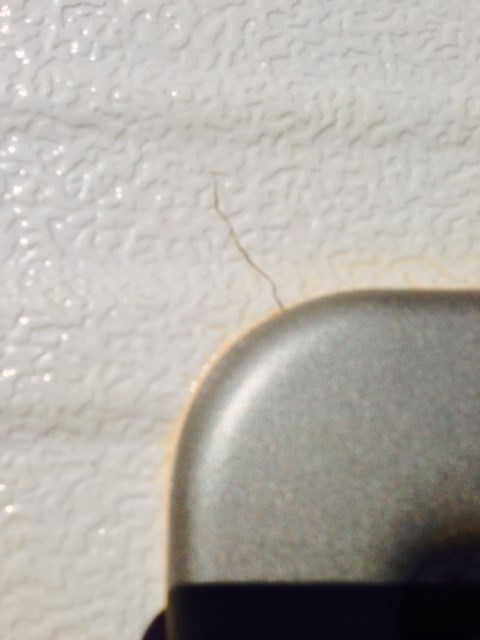

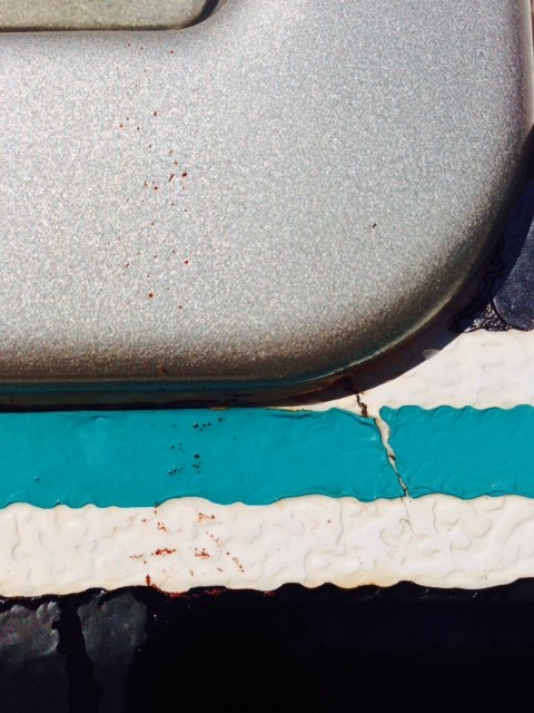

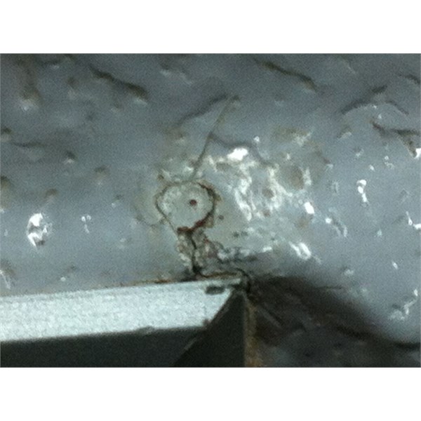

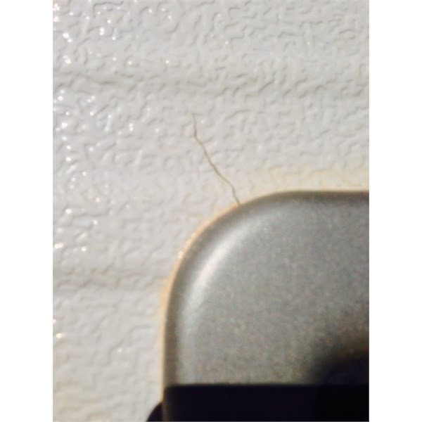

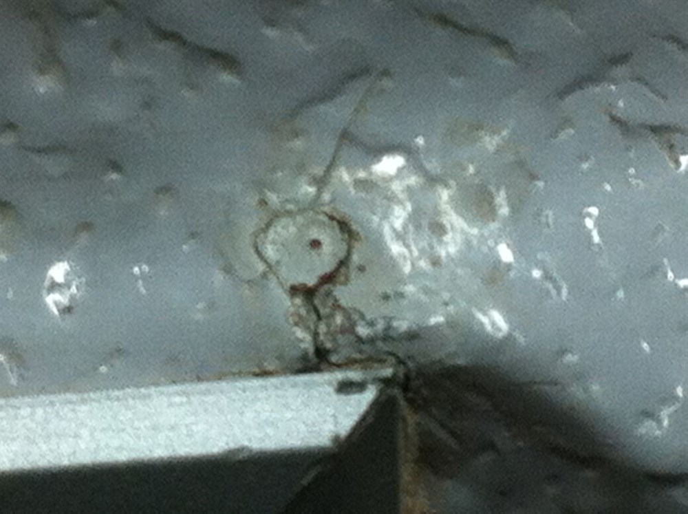

Hello there these are some photos of the cracks around the rear window in our bushtracker caravan. I would be extremely surprised if this is a one off problem. Simon and Deb

Reply By: The Hob - Tuesday, Aug 25, 2015 at 07:55
Wow Those cracks look serious and looks like a resking would be the only fix. We have done 70-80k in our van and quite a bit of that was on dirt road but thankfully we have no signs of cracks (touch wood) ours is a 2008 19ft

Reply By: cobar - Tuesday, Aug 25, 2015 at 17:56
Thank you for your responses . I contacted BT HQ early last week by phone and they suggested I drill the end of the cracks and fill them with Sikaflex . I said that because of the distance the van had travelled I think it is an engineering or design problem and would they come to the party to repair it . the answer , predictably , NO . So I Emailed the photos to them and asked what they suggest I could do and I would ask around to see if any one else had the same problem . No answer to my Email and the query I posted on the BT Forum was not put up !. Happy Travels Simon and Deb
