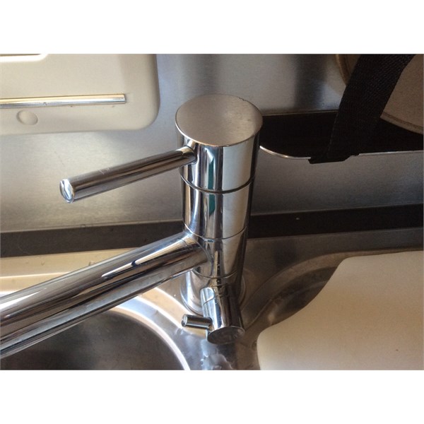

Can anyone help. I need to remove the handle assy. to get at the cartridge. On most mixers, removing the hot/cold indicator button gives you access to the grub screw to release the handle. On these units, I thought you just unscrewed the lever to reveal the grub screw - can't budge it.

There will be a grub screw somewhere,
If no plug at rear,maybe push the lever up (water off) and have a look in the gap between top and tap body for a grub screw
