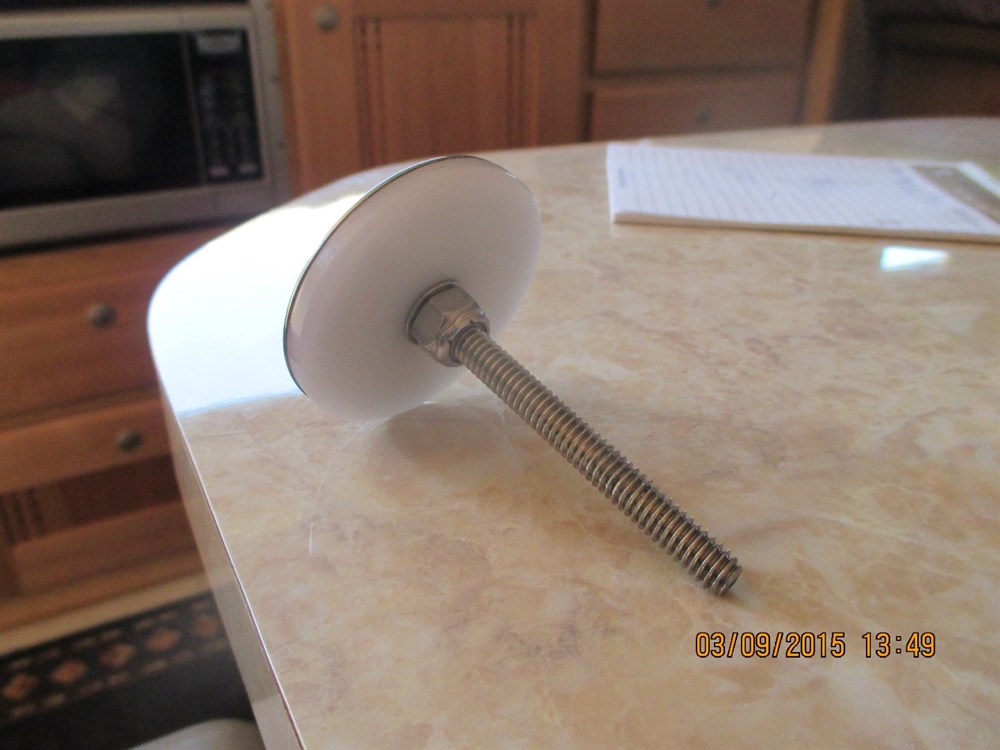

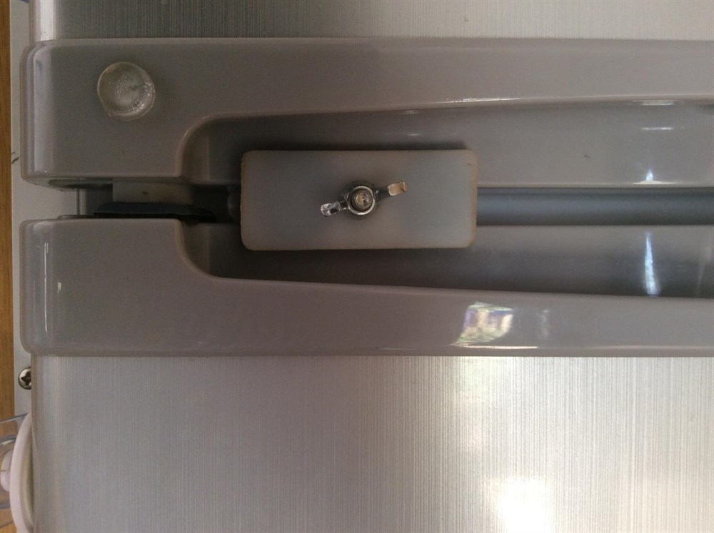

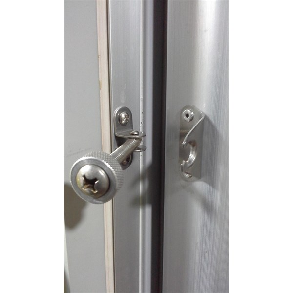

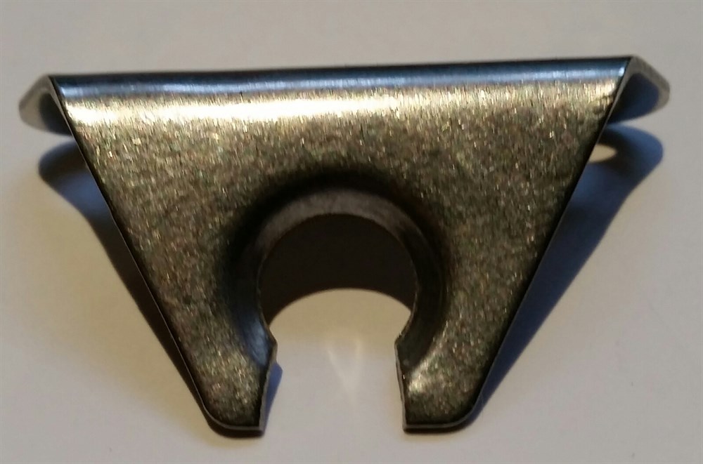

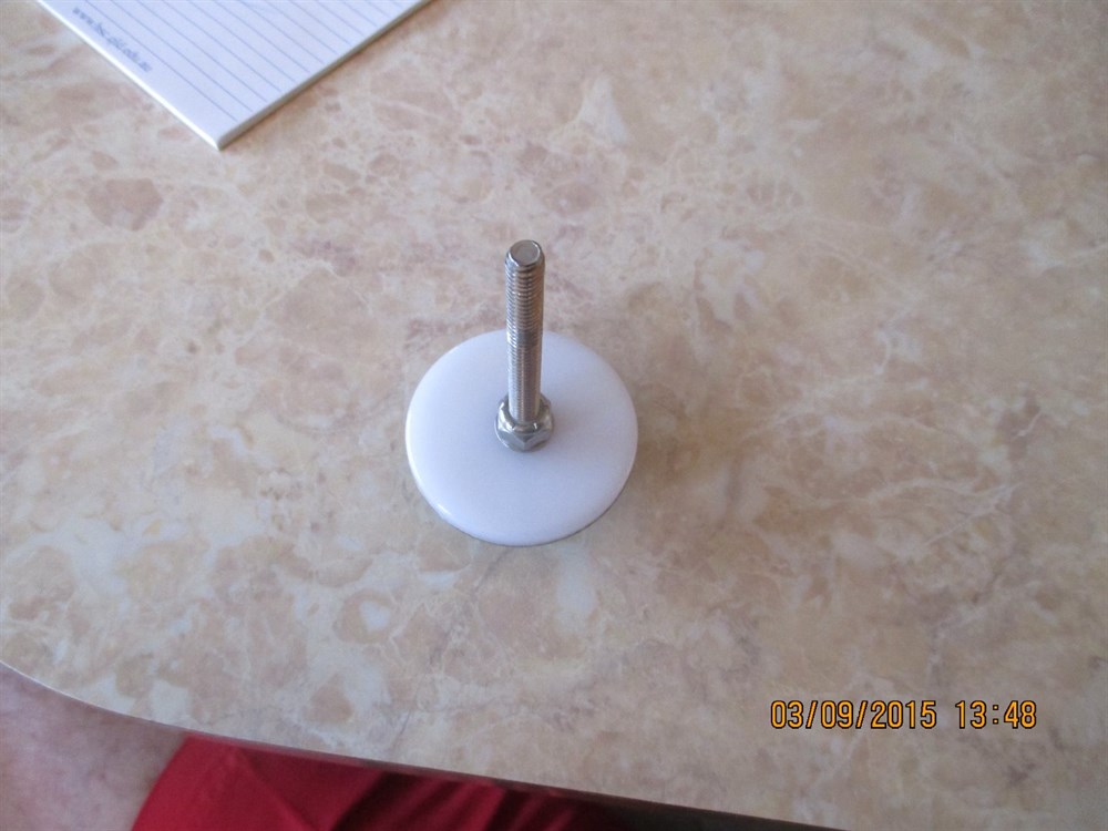

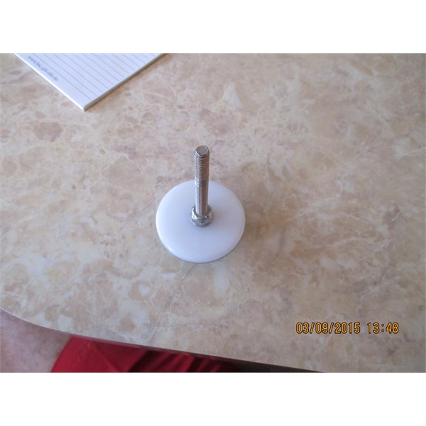

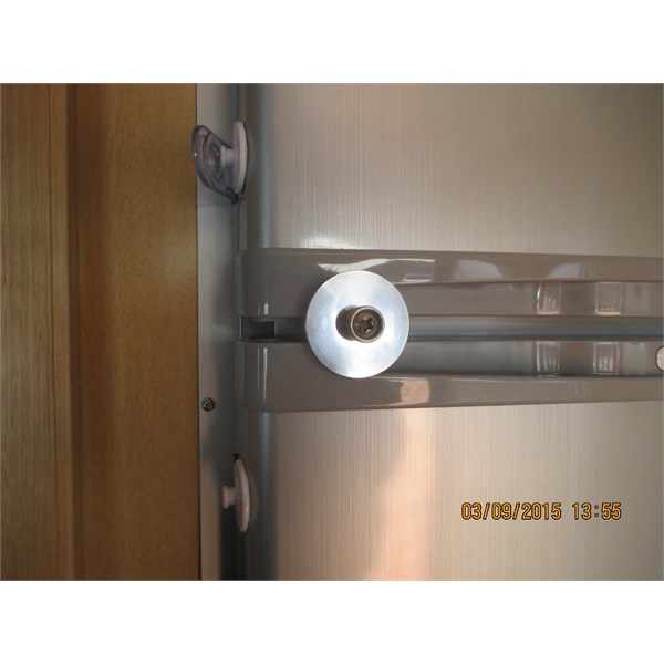

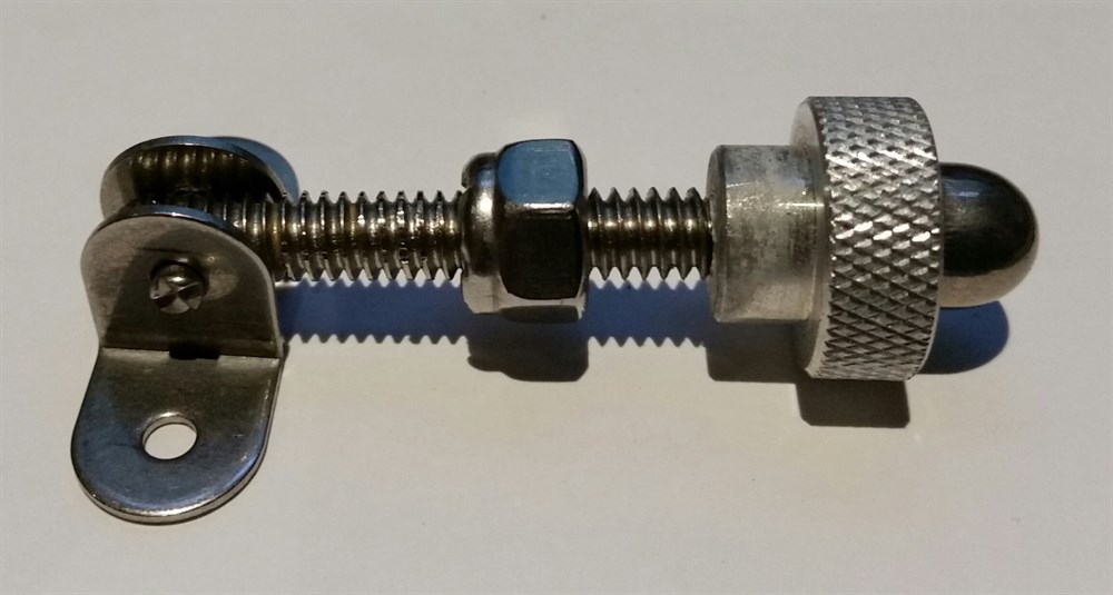

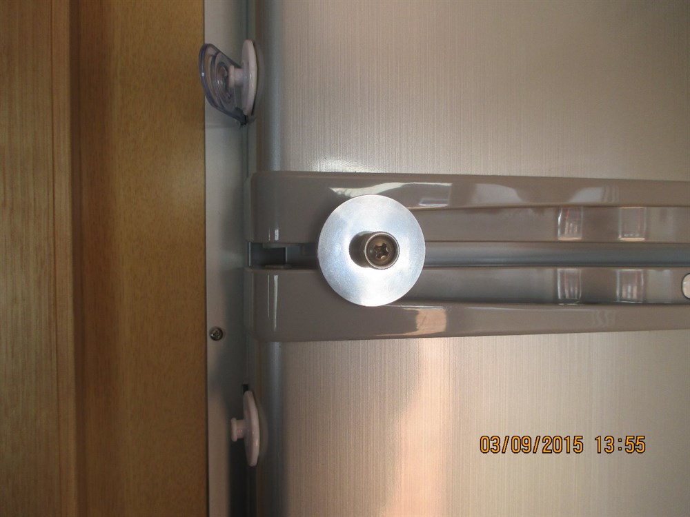

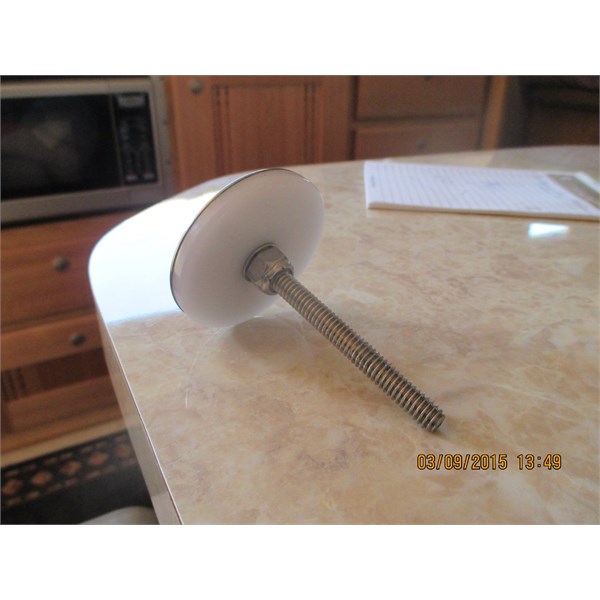

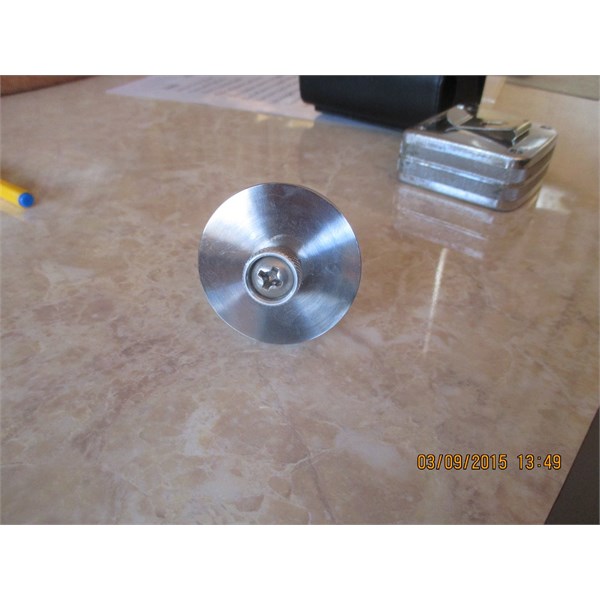

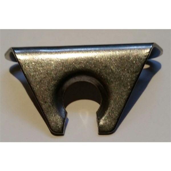

Reply By: BushBoss - Tuesday, Sep 22, 2015 at 10:09

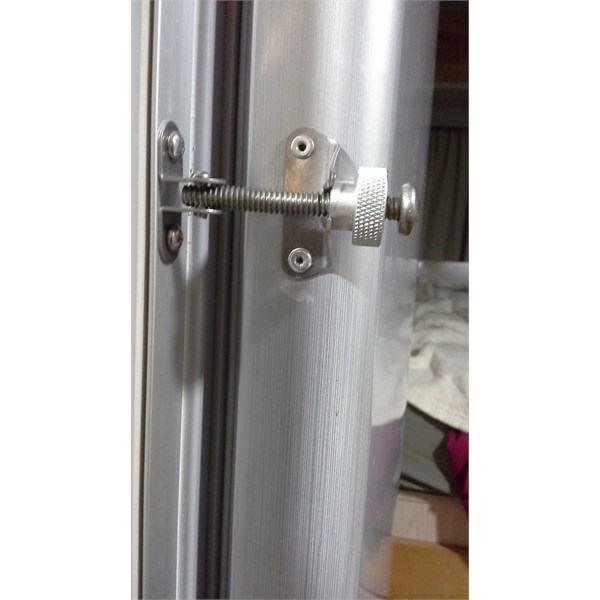

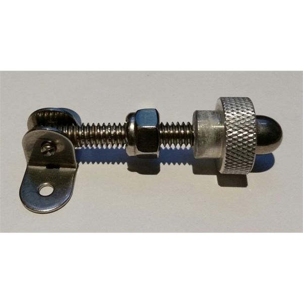

Hi Willie
a fellow BT owner had issues with a different style of fridge lock and was supplied with the same ones as you had fitted. He did not fit them but asked for a different style. BT came up with a good looking design which I have seen fitted before with success. You don't have to drill any holes as it fits into existing freezer mounting points on the opposite side to where the freezer door is mounted now. You could make one yourself or ask BT if they have them readily available. I am not able to give you any personal experience with this style of catch but I am going to make on and give it a go.
I have attached a few photos.
Hope this helps.
Lance
Pic 1
Pic 2
Pic 3
Pic 4
AnswerID:
590587
Follow Up By: Willie - Tuesday, Sep 22, 2015 at 11:12
Very interesting Lance. Very simple and it has to work. Thanks.

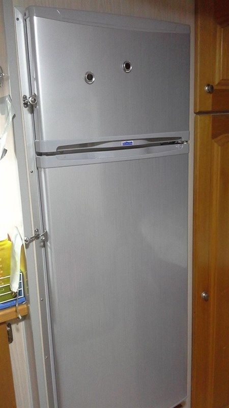

Reply By: Grumblebum & Dragon - Tuesday, Sep 22, 2015 at 18:09
Our type is the poly tongue and stud as shown on the side of the door on one of the images above...... has worked well for 10 years but..... you would have to shift the fridge forward slights to install the 'tongue'
Don't know where you would get them from it was fitted by
Bushtracker when we bought the van new in 2005.
AnswerID:
590610

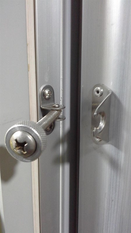

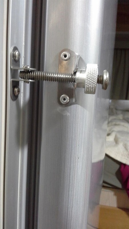

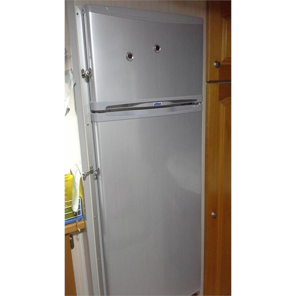

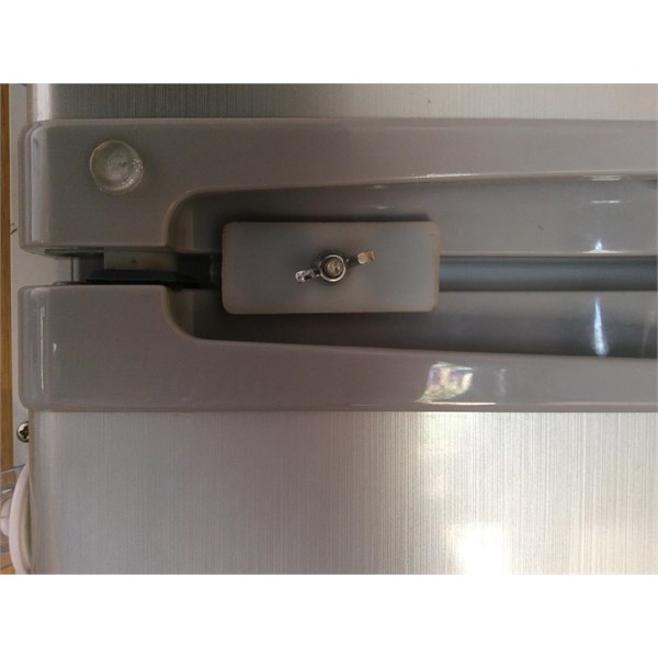

Reply By: AroundAustralia - Thursday, Sep 24, 2015 at 14:36
Hi everyone,
This is what I did on ours. No issues so far.
Cheers.
Fridge Lock
AnswerID:
590703
Follow Up By: muddywaters - Wednesday, Oct 07, 2015 at 10:07
Hi Michael & Wendy, We have done almost the same thing. It's a very secure closure though may not suit all fridge models. Andrew & Christine
FollowupID:
859370

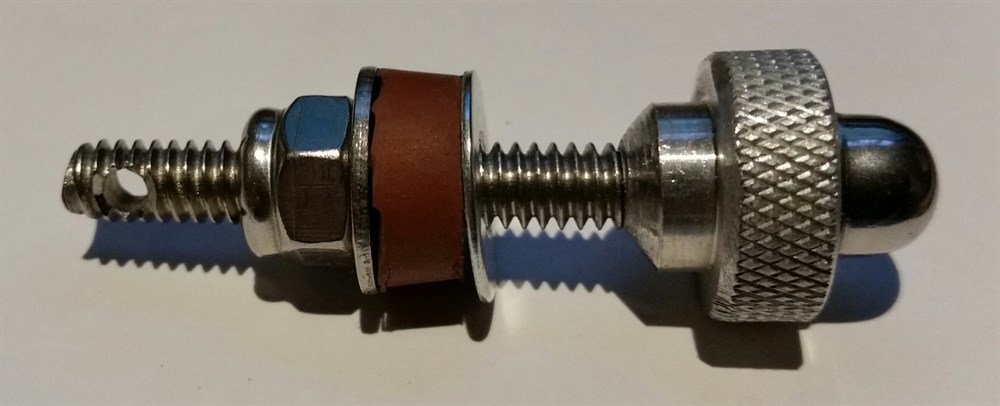

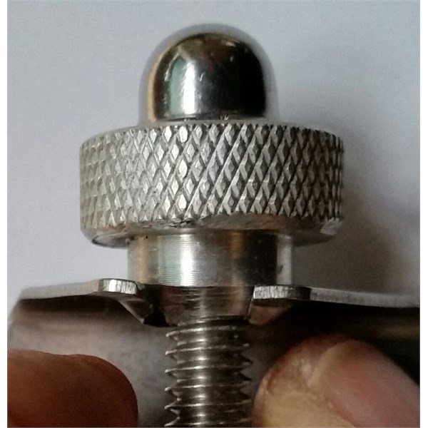

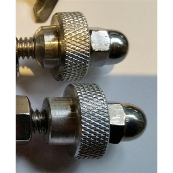

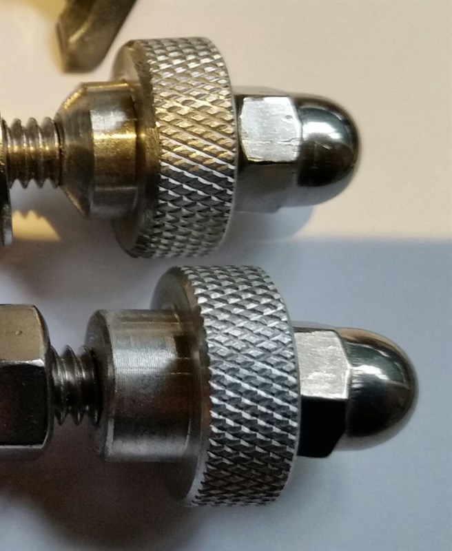

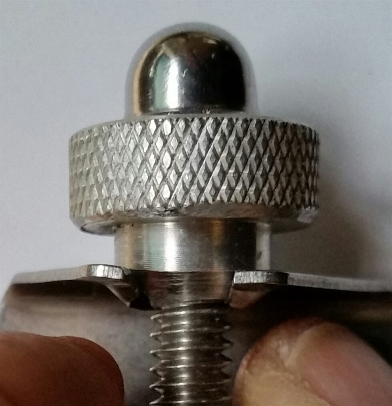

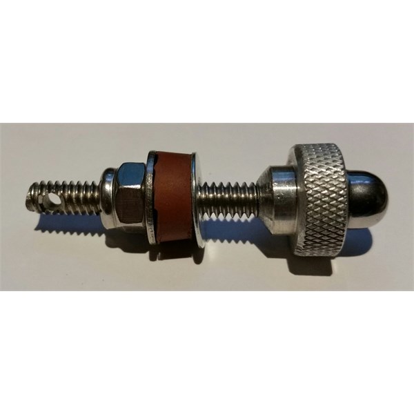

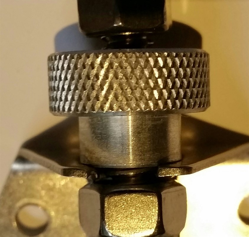

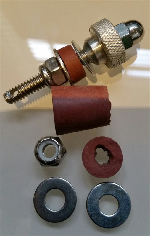

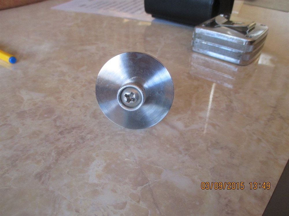

Reply By: Willie - Thursday, Sep 24, 2015 at 17:59

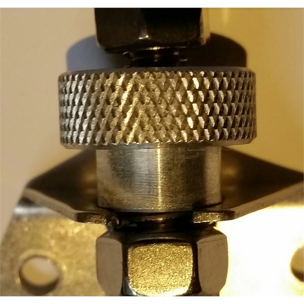

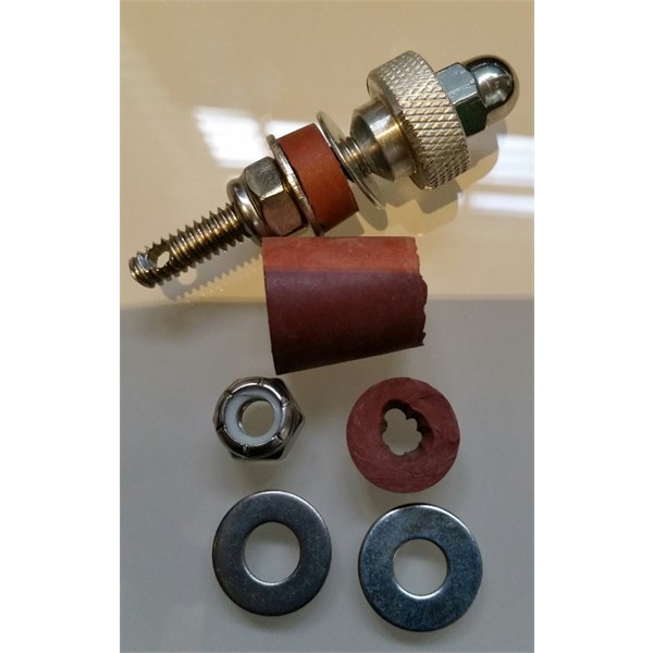

The improved part BT sent me with the Nyloc nut
My final Mod with tapered Knurled nut & washers
BT mod without taper, can move sideways
My tapered nut which locates positively in the depression on Plate A
My tapered part above, BT's part below
Locating depression in Plate A
My finished parts. I cut the bottom off a Clarke Rubber plug to make the washer
Bill ( of Bill & Rose ) asked me to email him photos as he had noticed the knurled nut loosening, didn't trust it and applied teflon tape to the thread to try to stop it happening. Bill, you asked me for photos of the parts, but they are all on here for you now.
Willie
AnswerID:
590712
