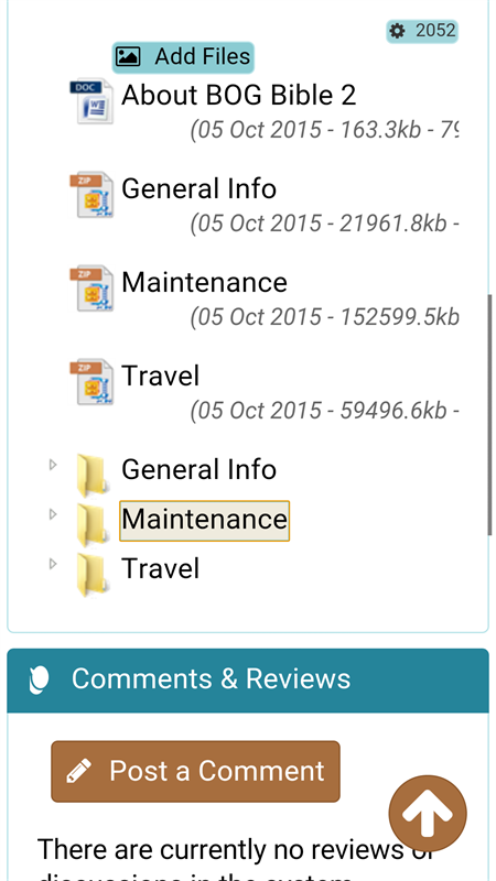

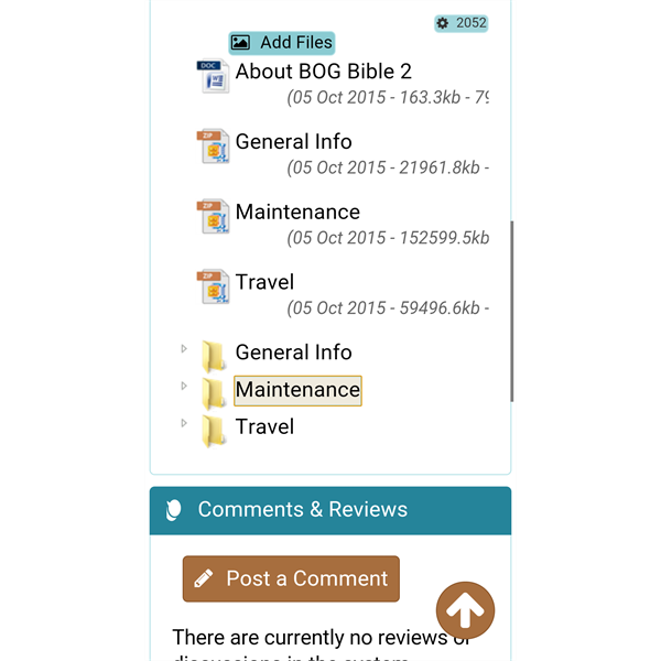

Allow you to download a zip file for storage of all the Bog Bible on your device.
The bottom 3 folders expand to show the individual folders.
Once you find the file you want click on it and it will download to your device. You may need to goto your downloads on your device then click on it again.
I downloaded all 3 zip files to my computer so I can access when I do not have internet service.
Hope this helps. If not contact me and I'll walk you through it.
