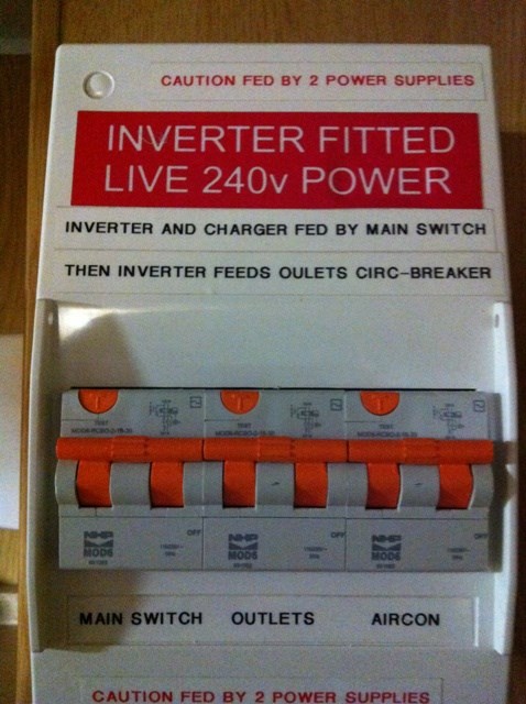

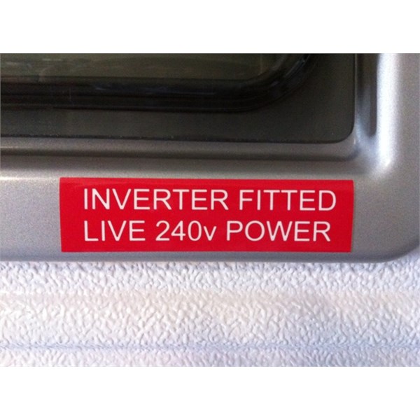

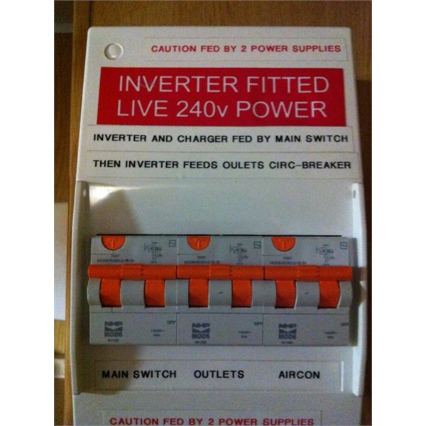

If anyone has their inverter running fulltime, it's important to alert others that there is live 240v inside the van.
In an accident etc, where people other than the van owners may need access to the inside.
We only run our inverter while stationary and we are inside, but I got these stickers through another Forum anyway, just to be on the safe side.
I put one on the external window frame near the door,
and one on the main power supply board.
