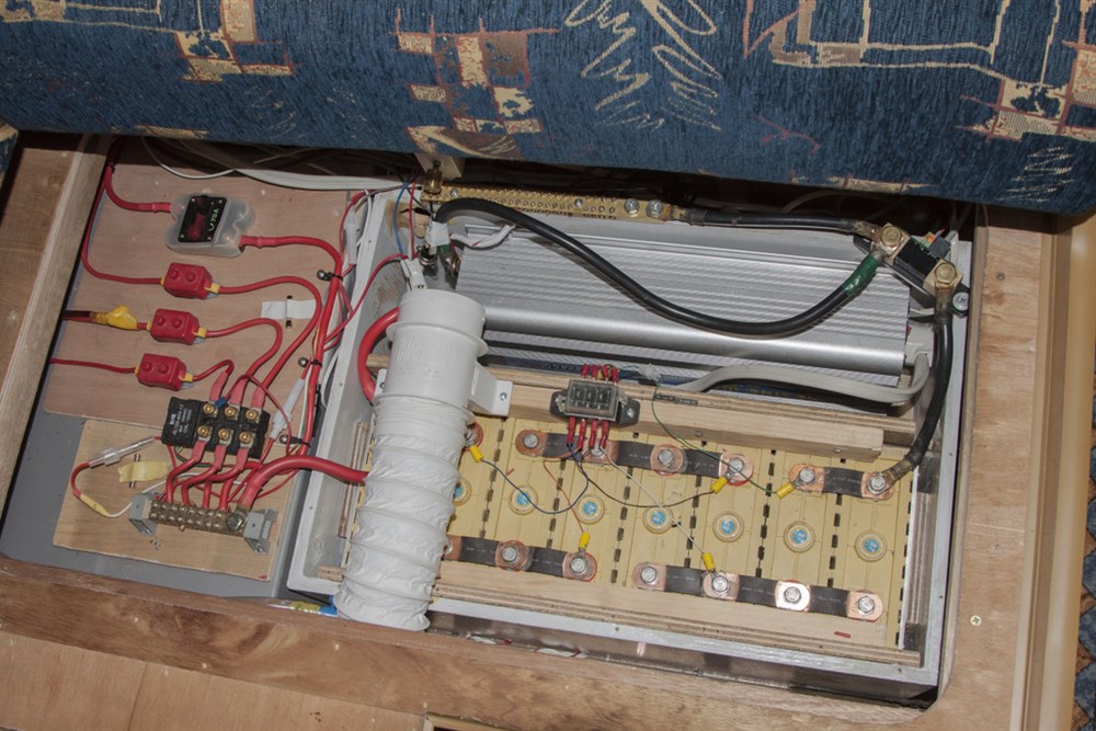

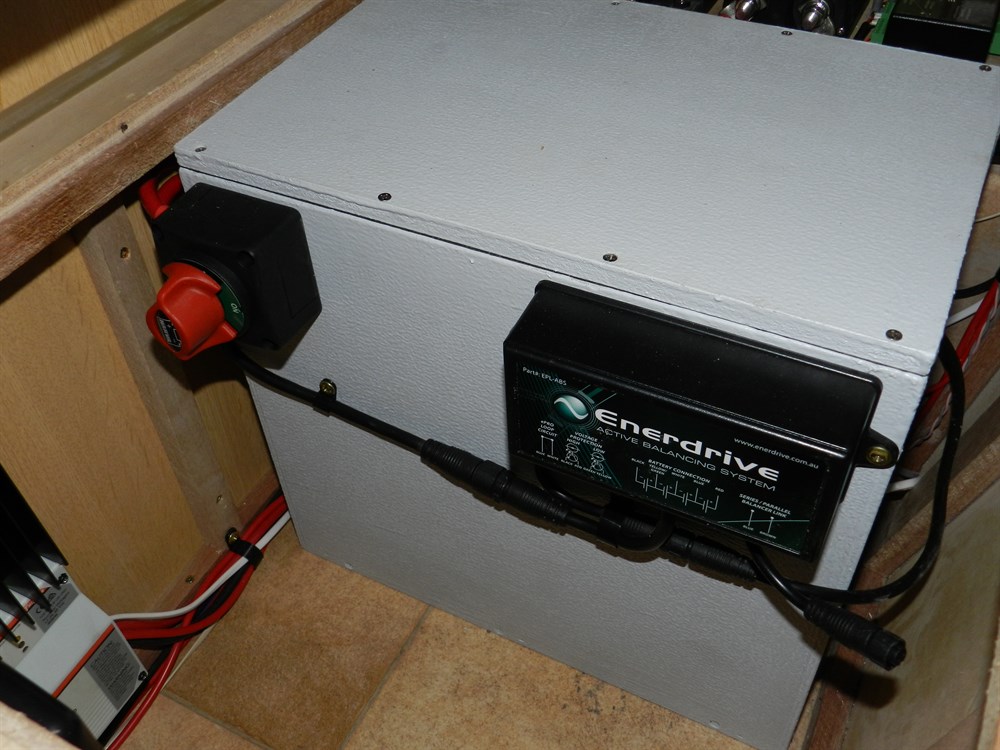

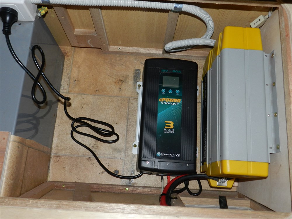

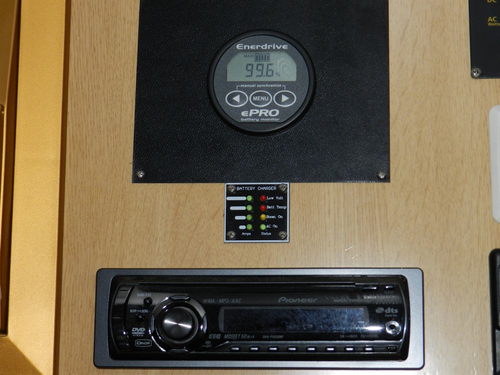

Reply By: The Hob - Friday, Oct 21, 2016 at 14:17

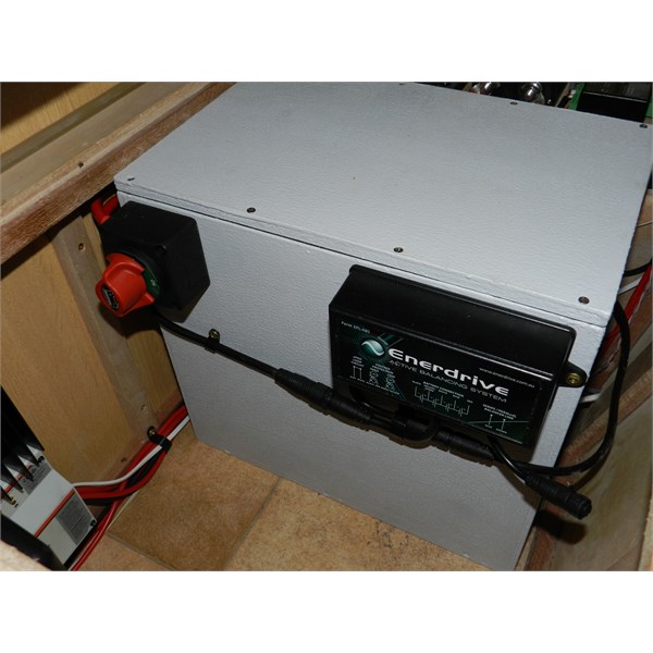

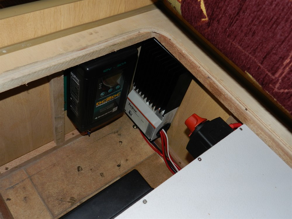

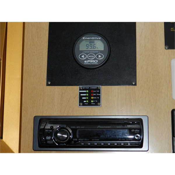

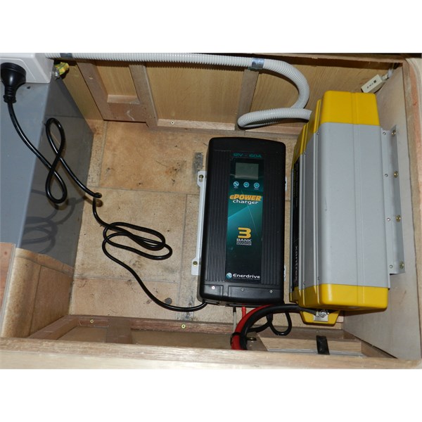

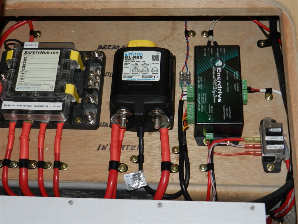

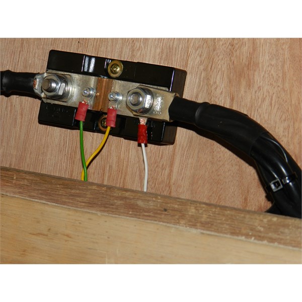

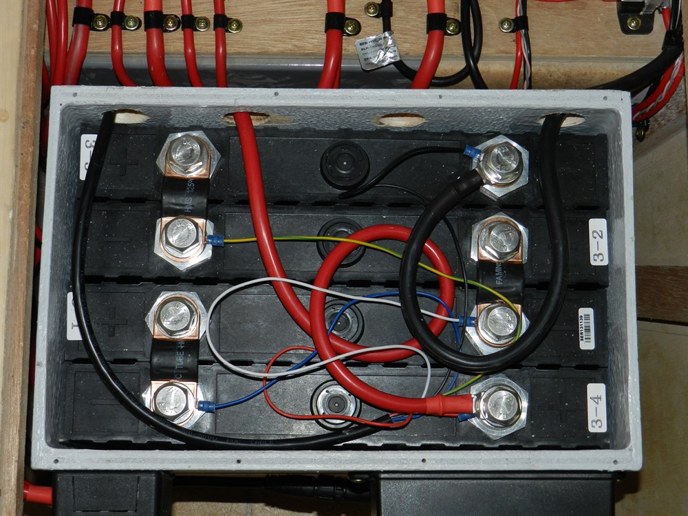

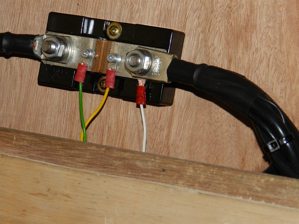

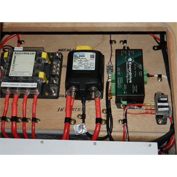

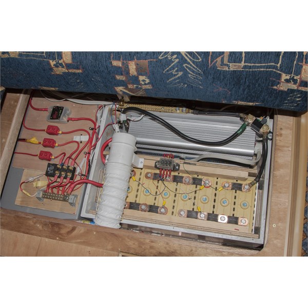

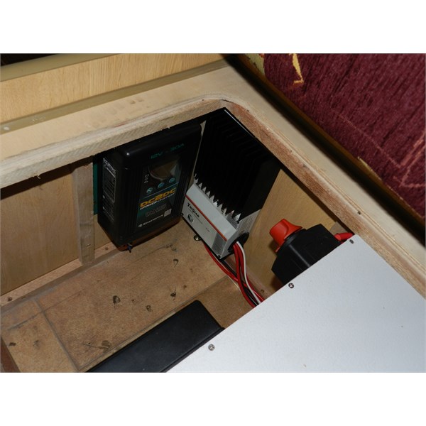

Here are some shots of my installation done by BTI

G'day Alan
Many thanks for your response - the pictures have been very helpful for me.
What is the ML-RBS switch used for?
Have you tried to use your air con on the inverter?
What capacity is your Lithium setup?
Using the Blueseas safety fuse is a great idea as it pretty much allows me to utilise the original Bushtracker wiring and makes it much neater than the original set up with all the positives leads coming off the battery positive.
I gather you would have saved some weight and gained a little more storage space.
Thanks again for your assistance.

Follow Up By: The Hob - Sunday, Oct 23, 2016 at 09:18
Grahame
It is a 300ah setup
The ML-RBS is part of the low voltage switching to protect the batteries (I think)
They also put in a large power switch to isolate the batteries if required. It is the large red knob gadget.
The 300 Lithium are a lot lighter than the 400 AGM. The area where the inverter and charger is was full of battery plus the old charger
FollowupID: 875086

Follow Up By: colin c - Tuesday, Oct 25, 2016 at 09:17
Hey The Hob
Are those cells in the picture held down somehow ?
FollowupID: 875135
Follow Up By: The Hob - Tuesday, Oct 25, 2016 at 19:09
Colin
Tight fit in the box and the lid of the box as well.
I don;t think they will move far
1
FollowupID: 875149
Follow Up By: colin c - Thursday, Oct 27, 2016 at 13:54
Just might mention the standard industry practice is,
that hold downs are able to hold 5 times the battery weight, in case of a roll over.
FollowupID: 875217

Follow Up By: Cook & Chauffeur - Thursday, Oct 27, 2016 at 08:40
Col
Thanks for that my email is:
greidnreid@gmail.com

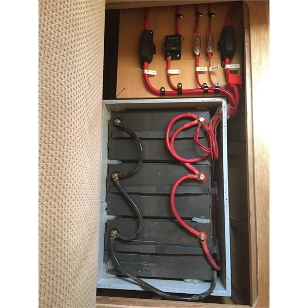

Mainly trying to get my head around the latching relay and how that works as against the original bt setup of all the pos leads coming off the pos terminal (see pic attached)

Sent mate
It's pretty straight forward, don't over think it.. LOL

Follow Up By: Bobrovin - Thursday, Oct 27, 2016 at 13:11
Graham
With the leads, just add in a couple of bus bars to connect all the leads to with single heavy leads to the battery posts
