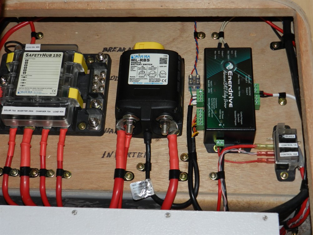

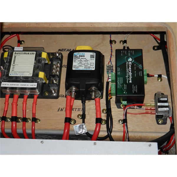

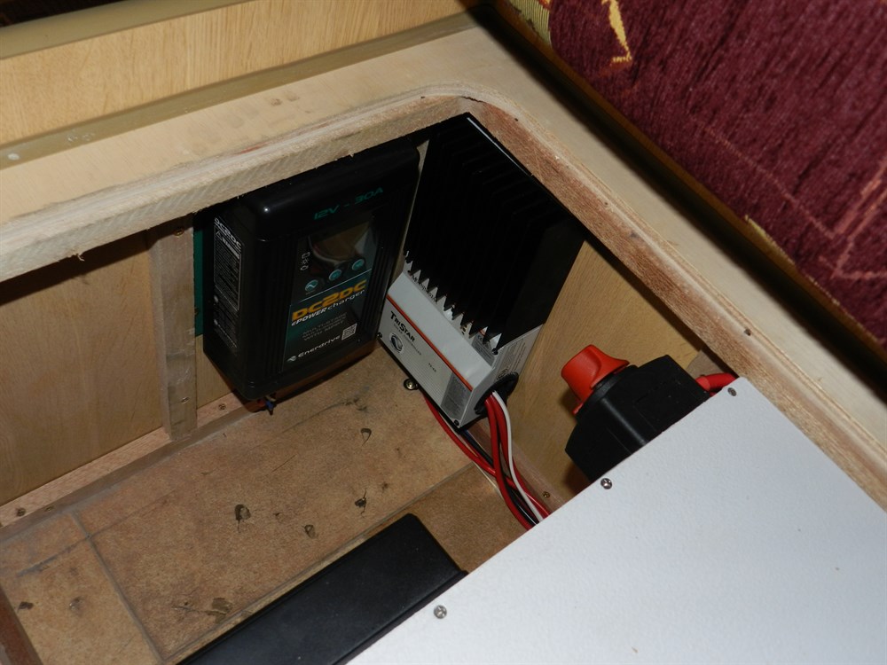

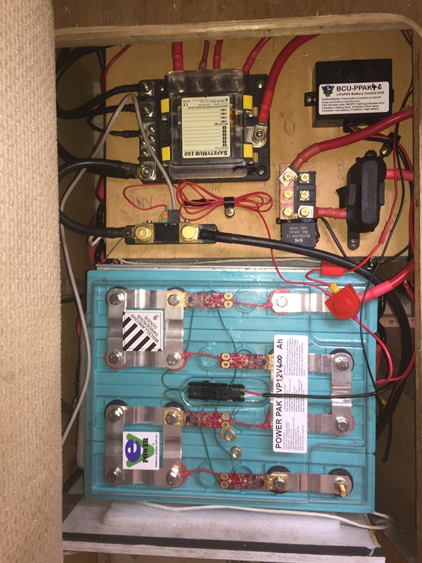

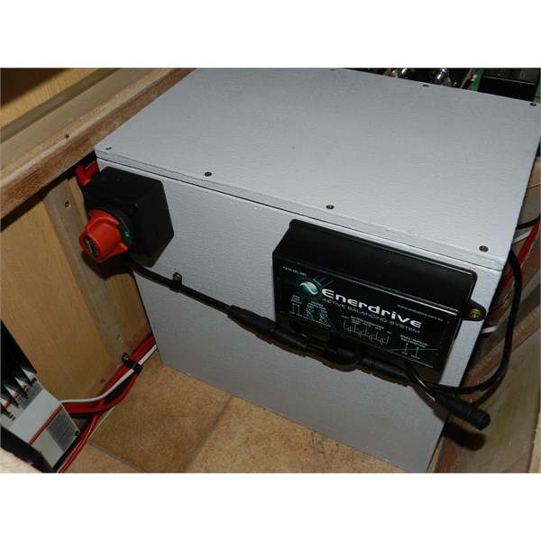

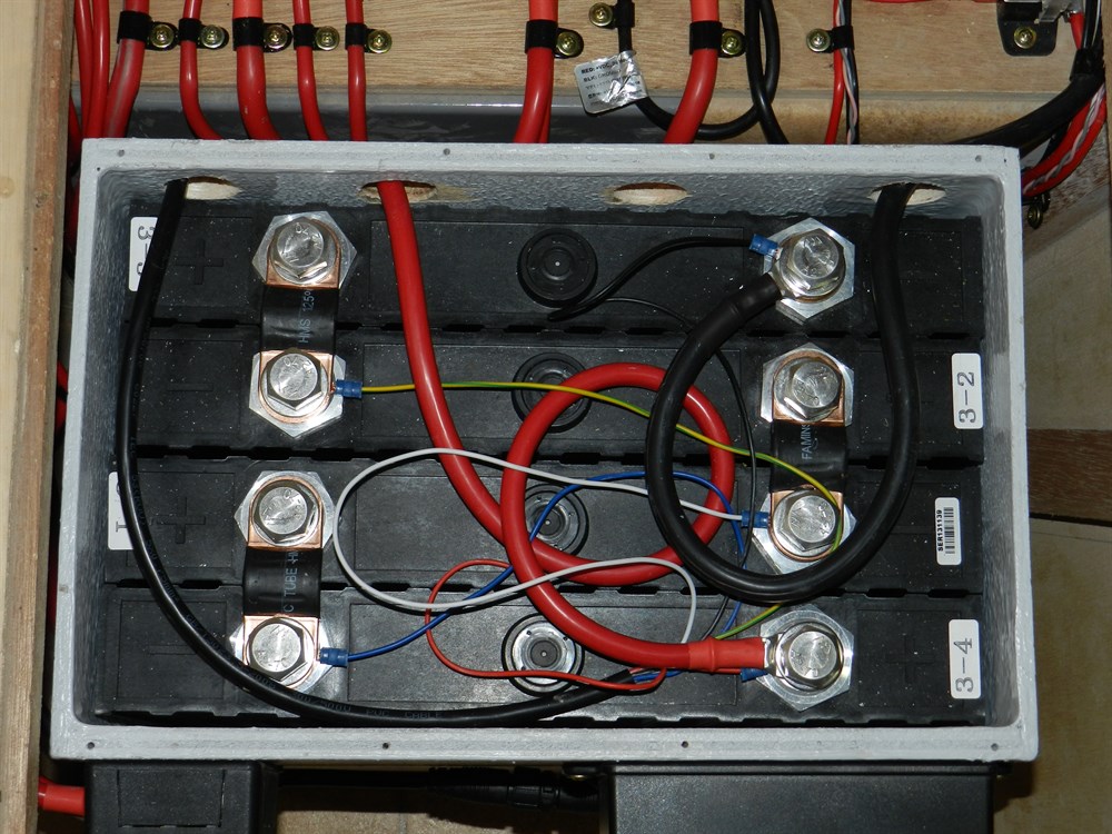

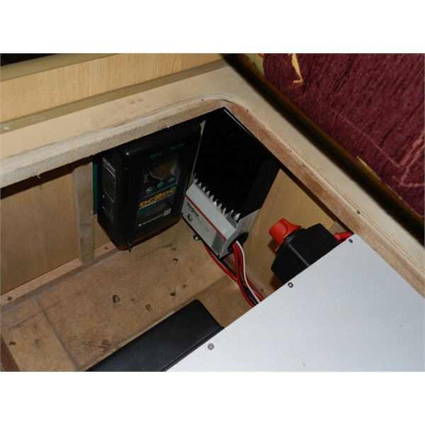

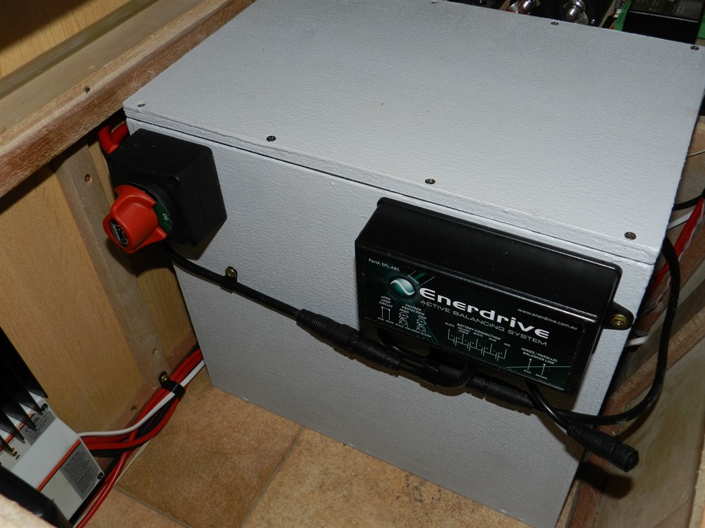

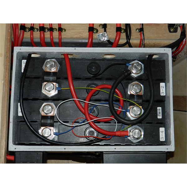

Don't know what items 35-38 are but here are photos of our retrofit.
I am totally wrapped in the lithiums

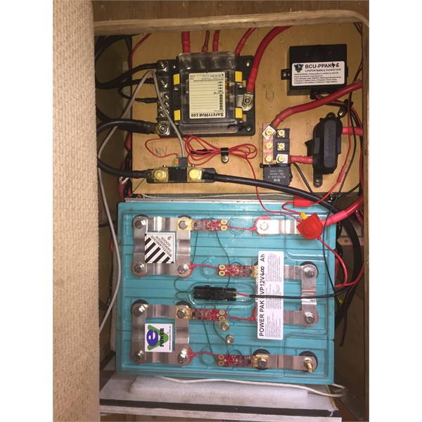

Reply By: colin c - Wednesday, Dec 28, 2016 at 10:22
Mate, ring Rod at EV Power, he will tell you what he recommends.
I have Xantrex eLite monitor, but high alarm set at 14.6V and low alarm at 12.2 V,
overly safe settings but an early warning to keep an eye on them.
Your set up looks great.
Maybe suggest that you clip/fix the cables where they connect to terminals to help take any pressure off the connections in rough conditions. You could also put a bar across the terminals on the relay of the BCU, the same as the other side, it will spread the load better.
