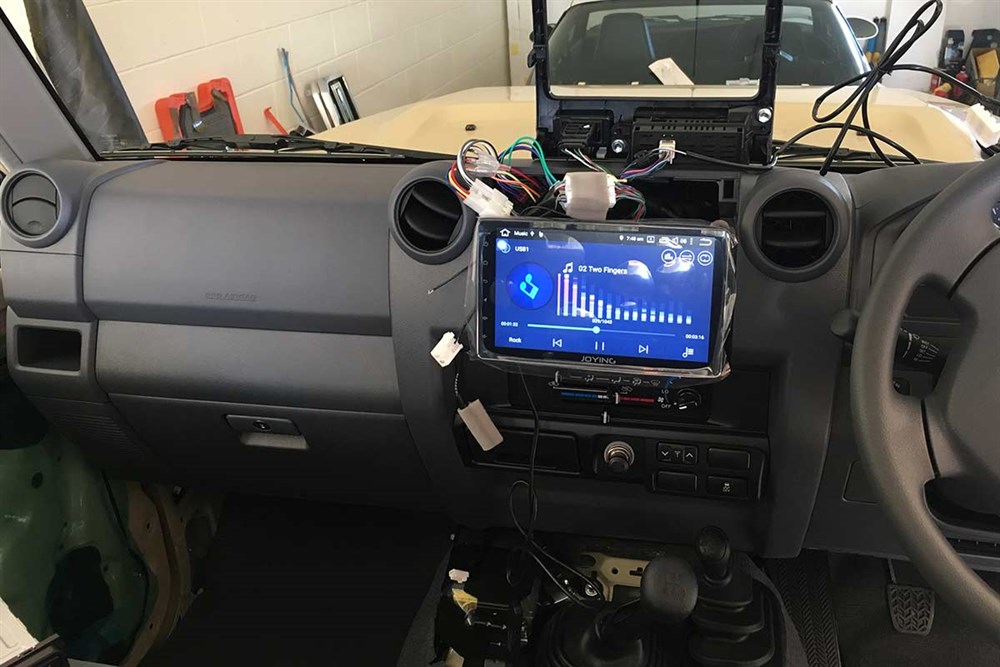

There’s a lengthy Thread on LCOOL with a bit of info:
Radio Thread
This photo was part of it. It looks like you might have to prise out that top part first.
Not a lot of help, but it’s a start.

Thanks for that Stephen. As you say it is definitely a start and makes me more comfy about reneging on the plastic surround.

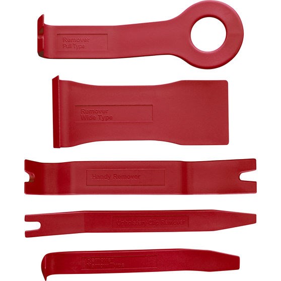

Dave, you will need some of these to pull the dash apart with minimal damage.
Trim Removal Tools

Thanks Stephen - worked a treat. 2 small slots at the bottom of the surround allow a tool to be inserted and pop the surround off.
